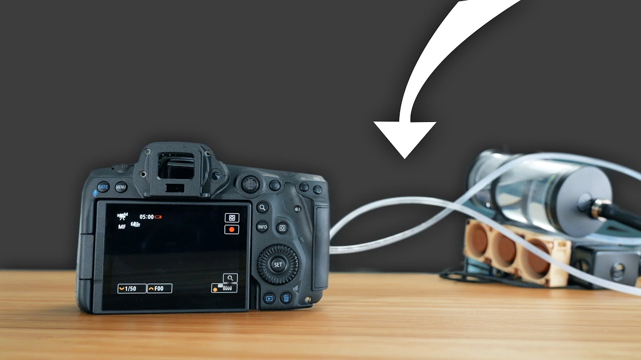

Canon Has Designed a Magnetic Liquid Cooled Camera
https://petapixel.com/2022/08/19/canon-has-designed-a-magnetic-liquid-cooled-camera/
https://petapixel.com/assets/uploads/2022/08/canon-magnetic-liquid-cooled-camera-800x526.jpg
Não tinha visto esse vídeo, o cara é bom no DIY.
