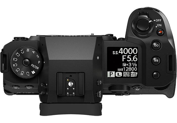

Que telão superior

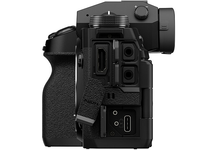

https://1.img-dpreview.com/files/p/E~TS590x0~articles/6216559909/Product-images/Fujifilm_X-H2S_grip_connector_port.jpeg
Dá pra manter uma bateria no bolso conectada à câmera sem atrapalhar a empunhadura da câmera. :clap: :clap: :clap:
Mas tem que ter uma placa protetora (possivelmente fixada na rosca de tripé) pra não quebrar o conector.

On the base of the camera is a fairly substantial connector with 15 metal contacts and what appears to be a USB-C socket. This is used for connecting the VG-XH vertical grip or the FT-XH file transfer grip. We have to assume the USB-style socket is used to transfer data quickly enought to the FT-XH, to make the grip’s Ethernet and fast (2 x 2 MIMO) Wi-Fi connections worthwhile. Don’t make other plans for the connector though:
it may look like a USB port but you can’t just plug in a cable for data or power connections.
https://www.dpreview.com/reviews/fujifilm-x-h2s-initial-review

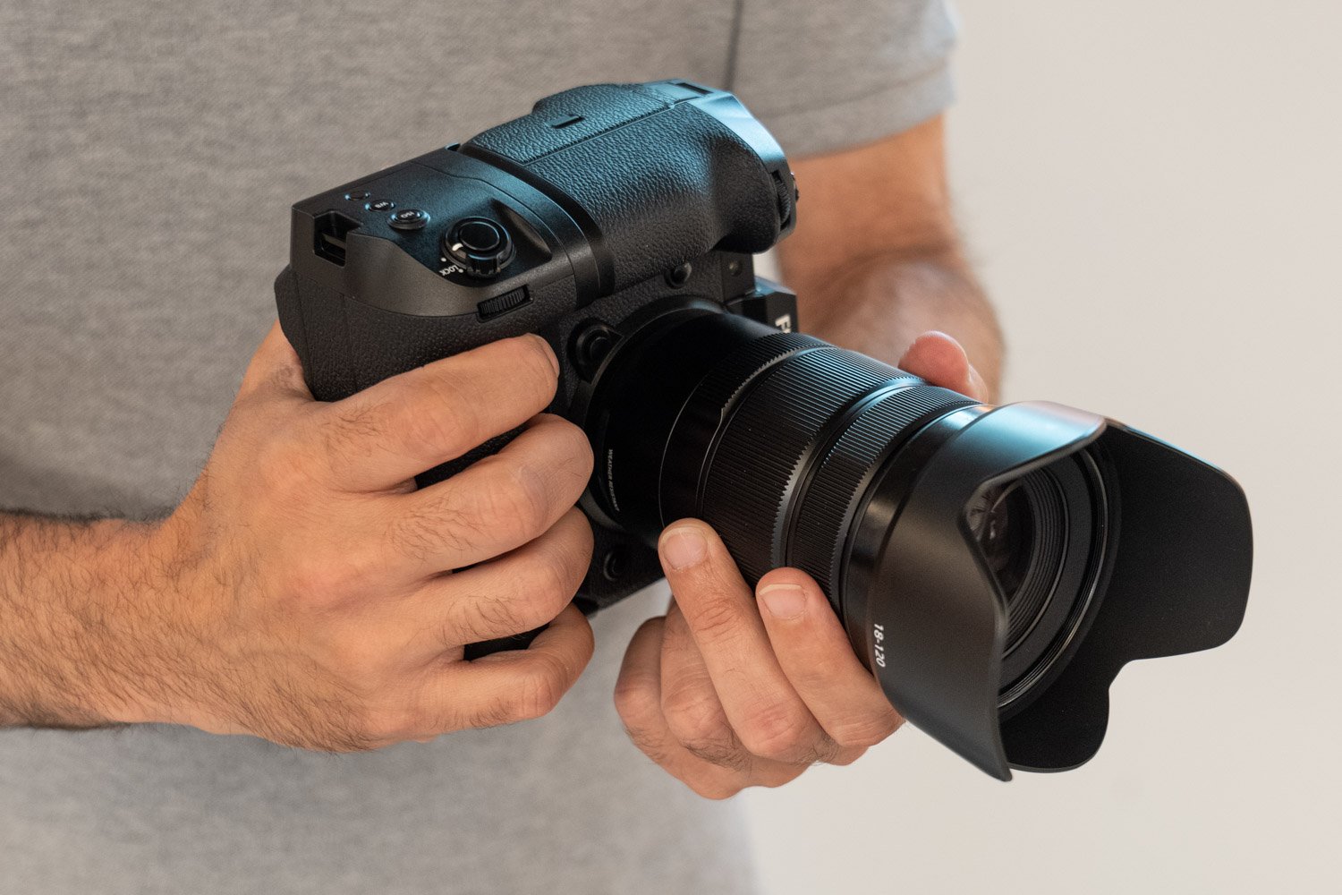

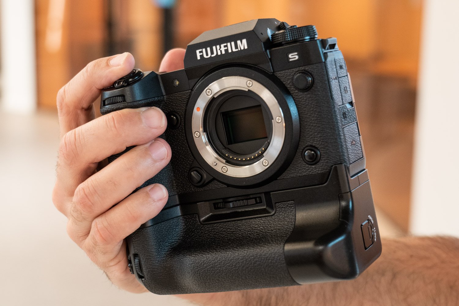

De fato, o conector mostrado na foto acima, é para ser utilizado com os novos Battery Grips, conforme mostrado a seguir:
https://fujifilm-x.com/wp-content/uploads/2022/05/vg-xh_1000x1000.jpg
b Vertical battery grip VG-XH[/b] (VG-XH | Accessories | FUJIFILM X Series & GFX - USA)
"…[i]The vertical battery grip is dust and moisture resistant and operates at temperatures as low as -10 degrees Celsius. It fits two of the high capacity battery “NP-W235.”
The grip features various buttons in convenient locations for vertical shooting to provide the same level of operability with horizontal shooting[/i]…"

X-H2S + Vertical battery grip VG-XH
Fonte: Fujifilm X-H2S: las claves de la APS-C más potente (y cara) del mercado | PHOTOLARI

Sim, acho que ele está li para uso com o Wireless transmitter grip, que vai ter taxas de transferências bastante altas.
Aliás, a porta USB-C “normal” da câmera é padrão USB 3.2 Gen 2, que suporta até 10 Gbps.
