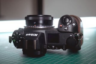

Como foi feito o teste (algumas imagens):
https://alikgriffin.com/wp-content/uploads/2021/05/AlikGriffin_FujifilmLensesOnZ6-2-L-574x382.jpg
https://alikgriffin.com/wp-content/uploads/2021/04/Fujifilm_35mmf1.4_ImageCircle-L-1536x1022.jpg
Fujinon 35mm f1.4 Image Circle
Artigo completo aqui: Fujifilm’s FX Image Circle - Bigger Sensor Possible? | Alik Griffin
